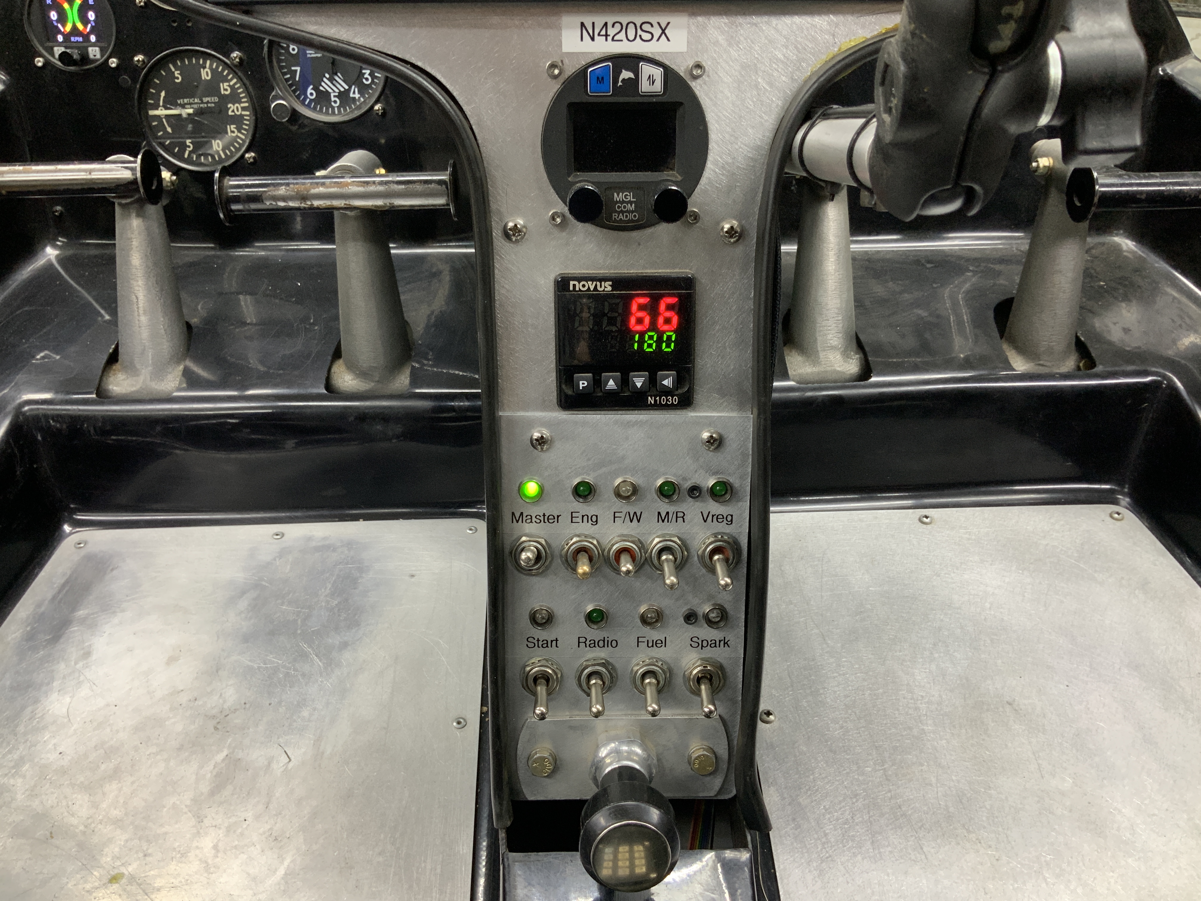

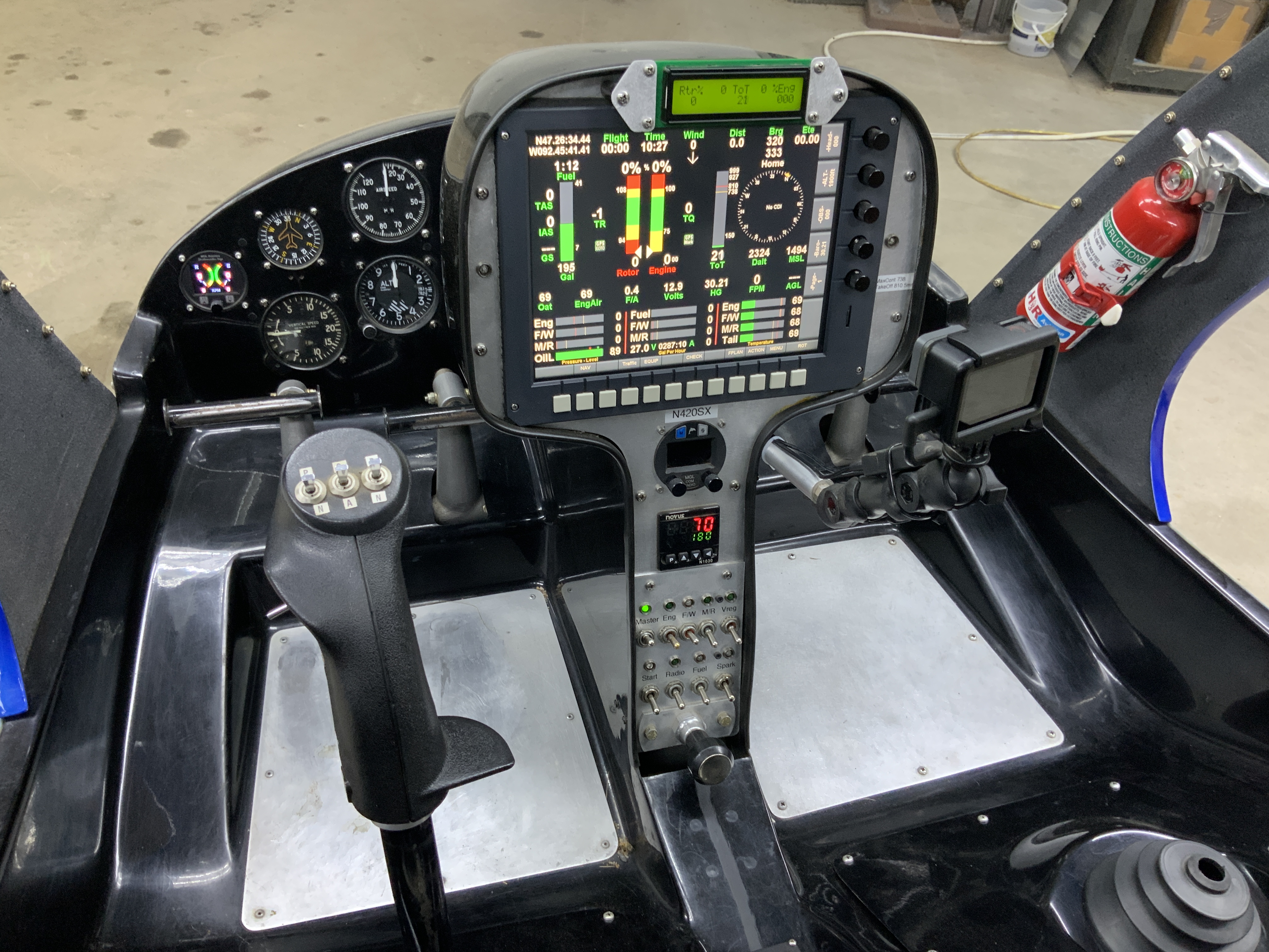

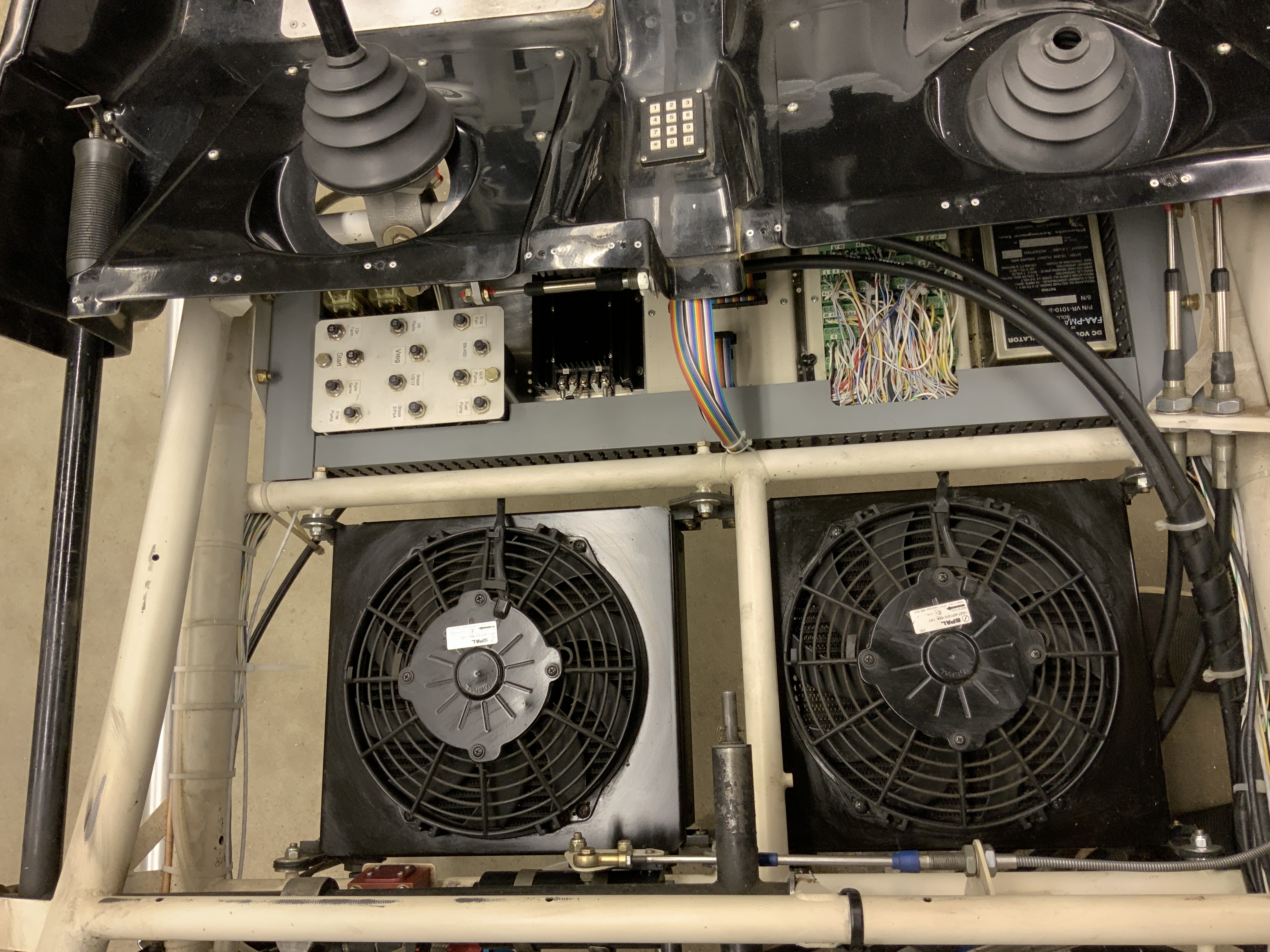

RE: Safety issue - Geno Mancini - 07-14-2026
I built an electrical "Tray" under the cyclic cross shaft.
It holds my computer, breaker panel and voltage regulator.
And all I have are 9 toggle switches.
[Image: IMG-0628.jpg]
[Image: IMG-1558.jpg]
RE: Safety issue - Orv Neisingh - 07-14-2026
Can you post some pictures Geno?
Here's another one
[Image: IMG-2311.jpg]
Very nice Geno.
