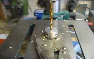

Once you have the fitting removed, drill a 3/16" (or close to that) hole in the top of the aluminum fitting as seen in the photo below.
[Image: Fitting1.jpg]

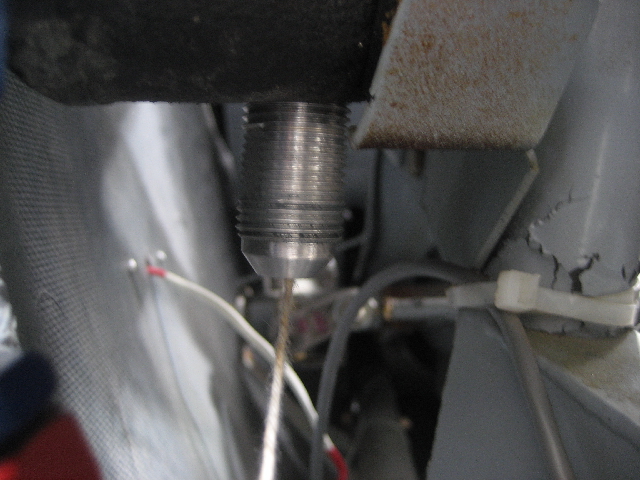

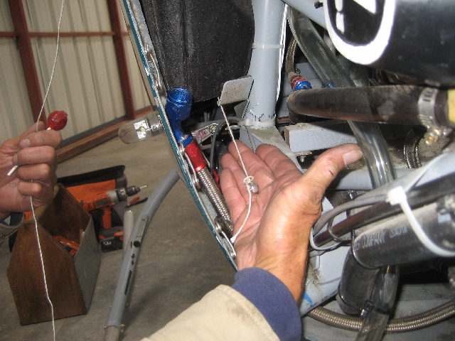

Next take a 10' piece of string and tie a nut to the end for a weight. The nut on the string is then dropped into the top of the tank and jiggled until it comes out the outlet hole in the bottom of the tank.
[Image: Fitting2.jpg]
The photo below shows the string with the nut weight coming out the bottom of the fuel tank. The Tootsie Pop is optional. You will notice a lot of rust and chipped paint on this ship. This is what happens when a frame is not primed before painting and when the ship is parked outside in the rain. It took me a week to get this ship airworthy before we could begin the builders flight training.

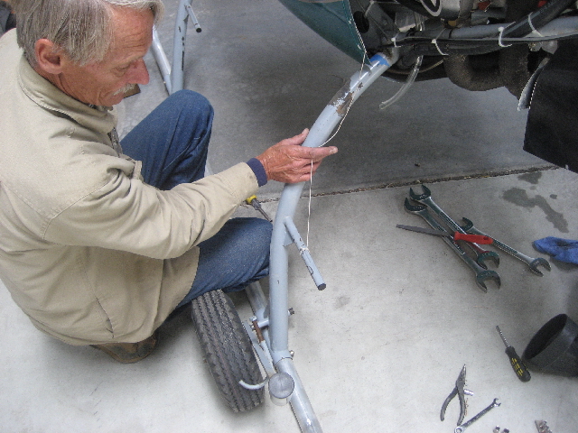

Tie the nut end of the string around the landing gear step to prevent it from accidentally being pulled back into the fuel tank.
[Image: Fitting4.jpg]

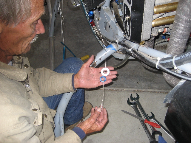

You will need to purchase or make a washer that will fit over the fuel tank fitting threads and bevel but not pass the small shelf at the upper portion of the bevel. This washer is what keeps the fitting from being able to exit the bottom of the fuel tank. You can usually find a washer that is close in size and then file or dremmel out the ID to fit the fitting. You don't want the washer to contact the bevel to the point that it does not fit snugly up against the flat shelf above the bevel.
The OD of the washer should be at least 1/4" larger than the OD of the outlet fitting top. If the washer OD is too large, it may not fit the space at the bottom of the tank.

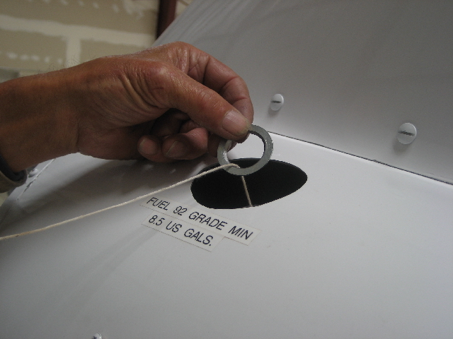

Place the washer and fitting onto the string as shown below.
[Image: Fitting5.jpg]

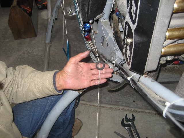

Next you will drop the washer into the fuel tank (with the beveled side facing up to mate with the fuel fitting bevel) and allow it to slide down the string to the bottom of the fuel tank. You can reach your finger up into the tank outlet and insure that the washer has room to fit flat against the bottom of the inside of the tank. Too large of a washer OD may not fit.
[Image: Fitting6.jpg]

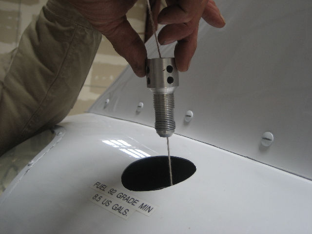

You do the same for the fuel outlet fitting.
[Image: Fitting7.jpg]

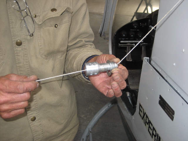

In the photo below the fuel tank fitting end has been slid down the string, through the washer, and out of the bottom of the fuel tank.
[Image: Fitting8.jpg]

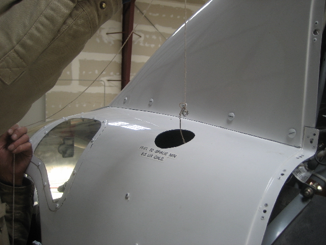

Now you should tie off the upper end of the string to prevent it from falling into the fuel tank as you are working on the bottom end. The string will keep the fitting and washer captive until you have them secured in place.
Slide the rubber grommet up the string and into place around the fuel fitting threads and inside of the tank hole. You will need to hold onto the outlet fitting threads to keep the fitting from going back into the tank. The grommet will hit the new washer inside of the tank.
[Image: Fitting9.jpg]
Next slide the bottom washer and nut up the string and into place on the threads of the fuel tank outlet fitting. Tighten the nut and then reattach the fuel lines on each tank when you are finished installing the fittings.
