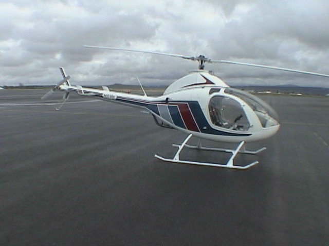

Quite a few years ago I was hired to instruct Bob K. in his newly built 162f. Bob told me that the helicopter needed to have the main rotors balanced and I had just purchased my new Pro-drive balancer and I was eager to try it out. John Spurling, who produced the balancer, this was befor Microvibe offered one to us, told me that if I had any questions, just give him a call.
I arrived at Bob's hangar and did a complete inspection of the helicopter, his workmanship was impeccable. After attaching the balancer sensors I fired up the engine and, sure enough, the main rotor system was really rocking the helicopter at idle RPM. I asked Bob if he had done a static balance and static lead/lag initial set up and he assured me that he had done them. As I increased the RPM, the helicopter began to shake even more dramatically to the point that I was afraid to take it to 100% RPM.
I called John Spruling and asked him if I could take readings with the helicopter still sitting on the ground and informed him about the very pronounced shaking. He told me to just bring it to 100% and lift off to get the first reading no matter how bad it was shaking. Well, John was the expert so I gritted my teeth, ran the helicopter up to 100% RPM, or at least it sounded like 100% because the helicopter was shaking so badly that I could no longer see the rotor tach. I pulled the helicopter into a hover and all I had to do was to use my index finger to push the button that I had velcroed to the cycle to get that reading except I had such a death grip on that gyrating cyclic control that I could not even loosen the grip of one finger to push the button.
At this point I thought that I was going to crash the helicopter but was finally able to get it back onto the asphalt pad safely. I still had no reading. I decided that once was enough of that kind of dangerous ride so I pulled out my rigging equipment and found that from the factory, the main blade rotor hub was off center by .007". That does not sound like much but the specs call for the hub to be centered on the main shaft to within .001". I reshimmed the rotor hub to spec and fired up the engine. This time the rotor system just purred smoothly and the reading in hover was around .2 IPS.
