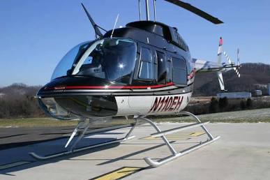

hose clamp failure - Graeme Smith - 09-04-2026 Sadly today another RW accident, this time it was the rubber hose coming off the U shape aluminium pipe feeding the heads, the hose blew off on final approach about 20 feet in the air up till this point all temperatures had been in the green, the engine faltered as it was sprayed with coolant. The pilot managed to get it to the ground with some great piloting skill by keeping forward momentum as the RW hit the ground, the landing hoops folded backwards and cushioned the hard landing. The landing gear did what it was designed to do fold back and absorb some of the impact, so all that was damaged was the landing hoops and skids, it makes me realise that if those hoops had been reversed the damage would have been a lot more as it probably also would of damaged the frame and whatever was attached to that frame ![]()
RE: hose clamp failure - Orv Neisingh - 09-04-2026 Or if the pilot had reversed the front hoop, lengthened and reinforced the skids he very well may have been able to just slide the helicopter onto the ground with no damage as I have done several times during an engine/mechanical failure. In over 13,000 hours of flying these ships and most of those hours were flown with the reinforced longer skid configuration, those longer skids and reversed hoops have saved many Rotorways from rocking forward and onto their left sides at forward ground contact. To each their own cup of tea Graeme. Just don't authoritatively tell everyone that the reversed front bow and longer reinforced skids is a bad idea, it is not. I present the facts on my website and let the owner/pilot decide what is best for them. https://rotorwayforums.com/flywithorv/www.flywithorv.com/hints/landinggear.html If the pilot came down vertically that hard the reversed front bow would simply spread out to the side absorbing the download. Glad the pilot is OK. RE: hose clamp failure - Geno Mancini - 09-04-2026 There needs to be a more aggressive shoulder on those aluminum tubes. And, the hose clamp needs to be compleatly one the proper side of that shoulder. I've seen hoses slip off of tubes many times if not done properly. Also the bolt style clamps are better than the worm gear clamps, they done come lose over time. RE: hose clamp failure - Lyle Swallows - 09-04-2026 Was this one flying with your Electric Fan conversion? I also see this is at a coolant hose area that is subjected to vibration/torsional flex from the moving engine to the stationary coolant pump/radiator. maybe there was a preload or not enough flex in the system and it wiggled its way out. how fresh is that rubber hose? is at all stiff due to heat cycling next to the exhaust? Lastly i love seeing the langing gear do its job! i personally am using the original gear setup with extended reinforced skids, i think it looks better, and i like the idea of the additional mechanical absorption apart from just normal spreading aswell. as for the reverse gear i agree it is more robust, but that stress must get transfered somewhere. at the end of the day i think to each their own, no crash is the same and we cant predict the nature of our forced landing or forced landing terrain. 90% of certified helicopters have their cross tubes straight up and down fore and aft and only rely on spread, so our forward or backwards hoop is kinda silly to debate. let us know when this one gets back in the air Graeme! i want to see more content of your conversions flying! RE: hose clamp failure - Graeme Smith - 09-06-2026 Hi Lyle, yes this was one of my electric fan, electric water pump and side scoops. My first attempt at the side openings, which later we discovered needed some side scoops to function properly All temperatures have been perfect with all fans turning off once in forward flight and the water and oil both in the green. When he flew into my place and overhead of me I saw green coolant start coming out of the overflow hose from the surge tank, so I knew something was wrong, he was a little high and a little slow and he was on the ground from that sighting in about 10 seconds, The pilot said just as he was coming in and about 5 foot off the ground he heard a loud bang and he started to rotate he nosed forward and applied pedal and landed hard, he exited the RW and what looked like smoke started pouring out of everywhere we both backed off but we then concluded it was steam and it was everywhere. He walked away un scathed, there is a GoPro recording I think, so maybe it will tell us something when I get to view it. The hose was in good shape it just blew off, maybe the hose clamp failed or became loose not sure we might start delving deeper today after all it was Father's day yesterday so dismantling a damaged RW was not at the top of our lists, I am just grateful it did not hurt anyone, and grateful it had the std landing gear. I know I will be looking for an answer and will see if there are better hose clamps we can reassemble with if the clamp has failed. Or it could simply be no-one re checked all the hoses after the 25hours of running. RE: hose clamp failure - Geno Mancini - 09-07-2026 There needs to be a more aggressive shoulder on those aluminum tubes. |
