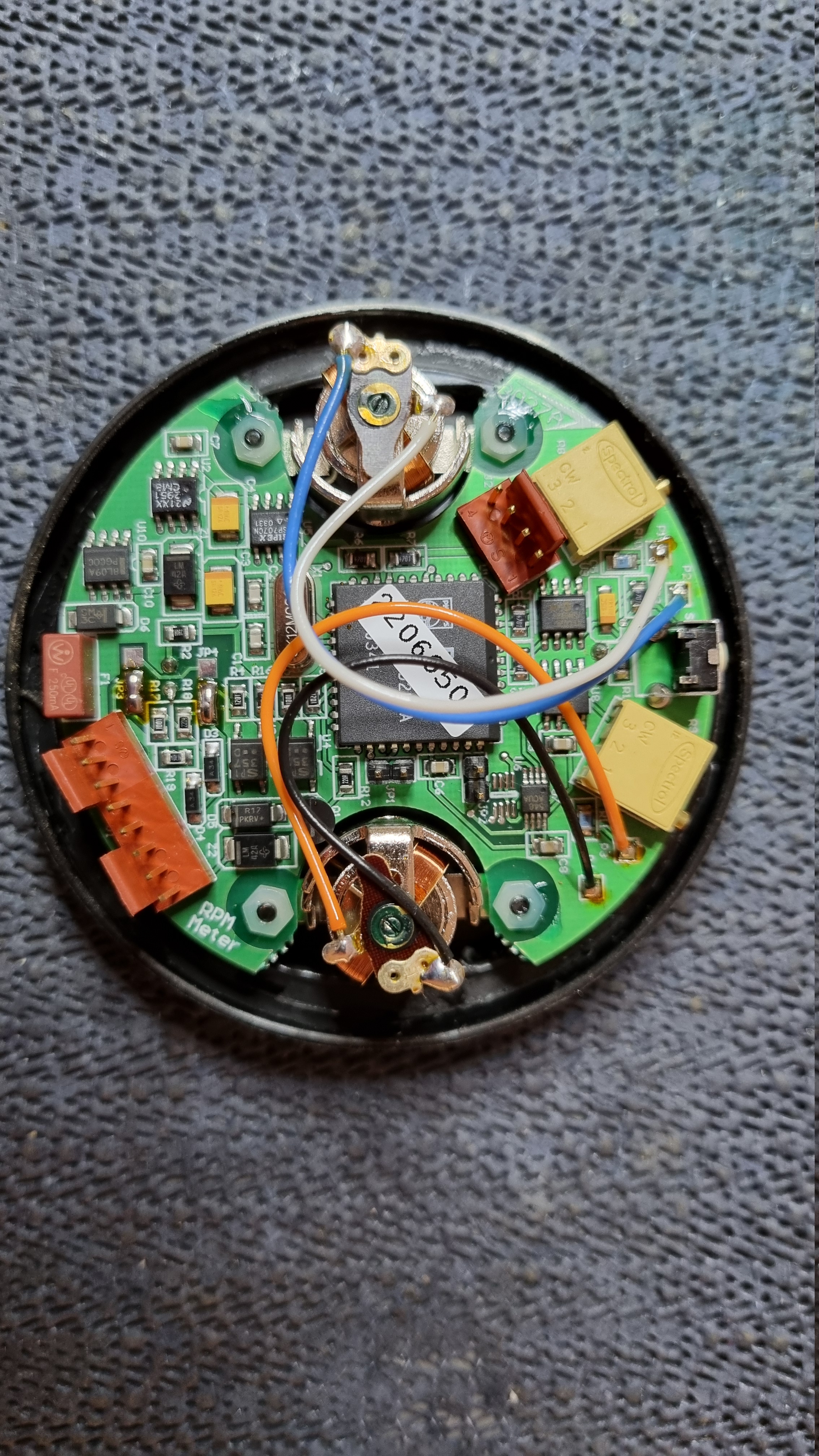

Sadly I do not have a photo of the original digital circuit board.  But soon after releasing the new digital RW upgrade we got approached by Russ Gerrish around  2002 who had heard about our rotortach and was after one to suit the Jet Exec.  And that started a whole new interesting chain of developments of the product that continues to this day.  That will all be covered in my Part 2 of the story.  Attached is a photo of the revised circuit from 1992 that was resigned to suit both the standard RW and also the Jet Exec. That’s 24 years ago!  I just can’t believe where all the years have gone.
[Image: 20260925-183941.jpg]
