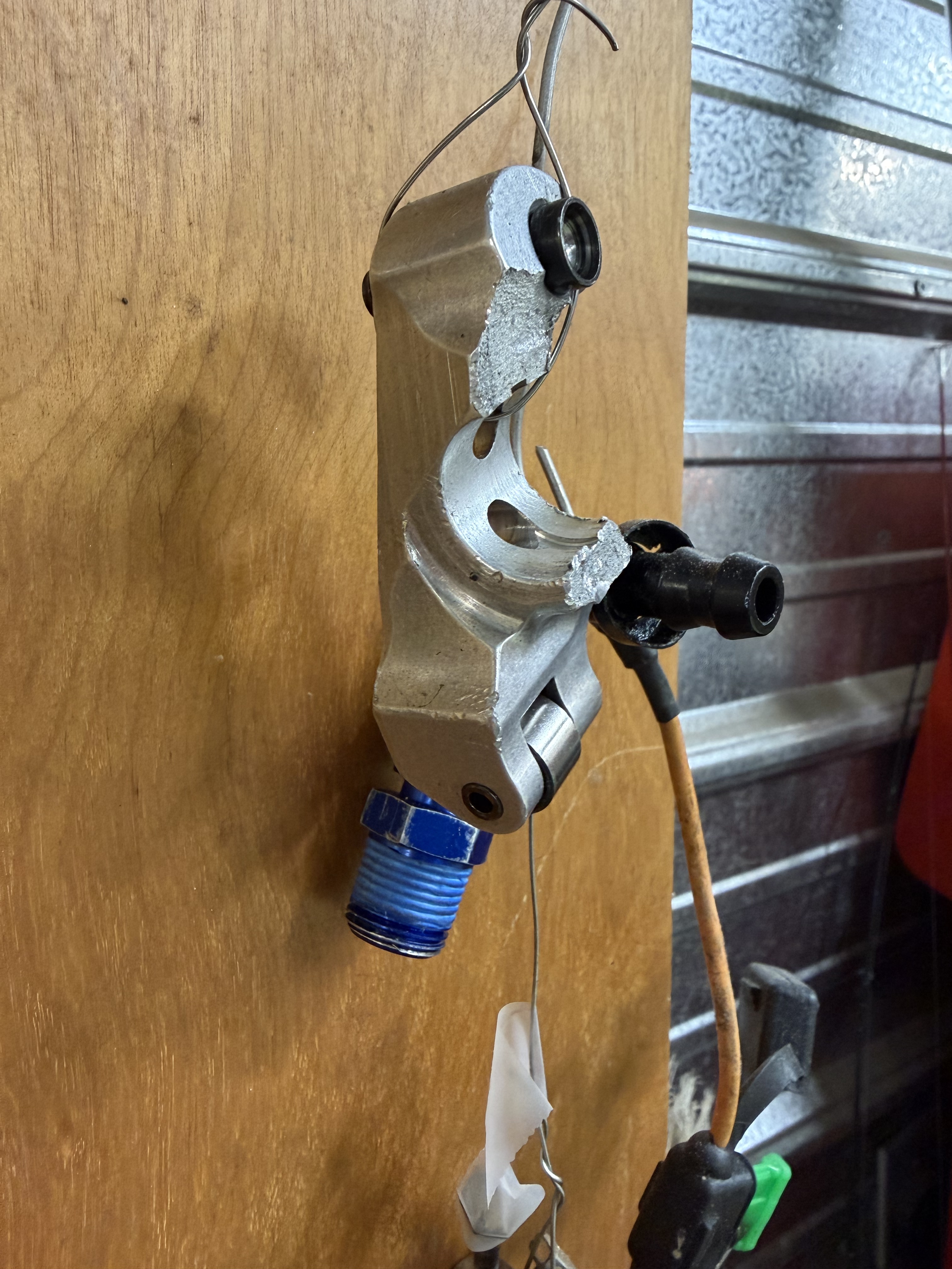

Mine didn't blow up in flight, but it was eating itself up. If I had continued to use it, I would have had a catastrophic engine failure. I ended up pulling the engine and getting Joe Huff to fix it.

Wise choice Tim. One engine out in your ship was certainly enough to get both of our attention. No repeats needed.

i am curious what caused this cam failure? was it the same engine with that siezed roller shaft rocker?
for the longevity of this design these engines have to be overhauled or a replacement engine found that can be deemed reliable and servicable. i'm thinking 20+ years down the road, joe huff has expressed he would love to retire someday! haha.

The cam failure was caused by the engine builder installing hydraulic lifters in the engine. These bleed down when the engine sits then take a while to fill with oil once the engine starts. That period of time that the engine is running and the lifters are not fully filled caused the damage.

thank you for keeping these "lessons learned" hanging on your wall there.
