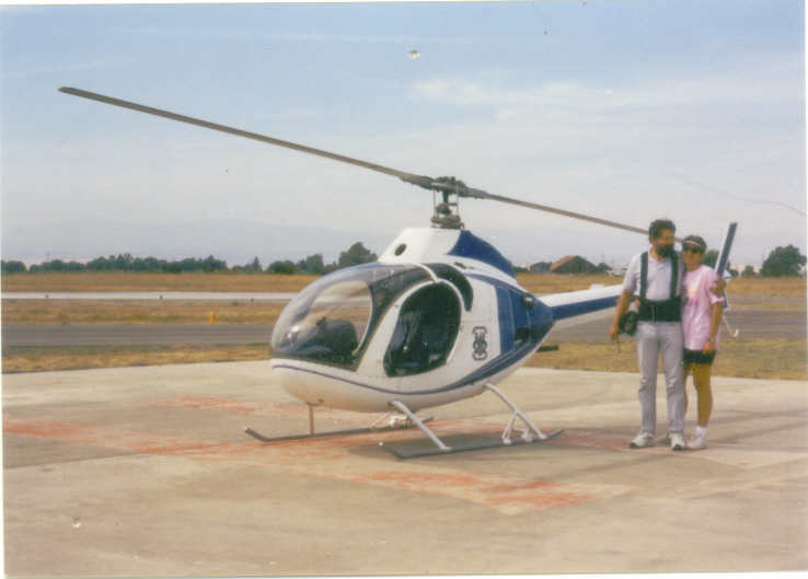

The photo below was taken at one of our Western States Fly-ins back in the early 1990's at the Orland County airport in northern California. Sheila and I are flying our Exec 152 past friends checking out a Scorpion II while Dan Vandusen was doing aerial photo shoots from his Exec 152. About this time Rotorway came out with their latest model the Exec 90. The 90 had landing gear that was around 6" taller than those on the 152, A taller main rotor shaft by 6" and the doghouse did not have the air intake hole in the front that the 152s all had.
I wanted to modify my doghouse to make it look like the new Exec 90, who needs a hole in the front of the doghouse anyway? With a couple of late evenings worth of work I covered the hole with fiberglass and painted it to match the rest of the doghouse and I was really proud of my handiwork. I hovered the helicopter and monitored the temps and all appeared normal after the modification.
Some friends invited us to join them for lunch in Lower Lake on the shore of Clear Lake in northern California and I was excited to show off my dog house modification to them. We set a time for Sheila and I to meet them and called just prior to lifting off. It was about a 60 mile flight which we could easily accomplish in about an hour. We left our home around 11am and began transitioning our route from the Sacramento valley over the coastal range mountains. Our route had us climb several thousand feet and as we climbed over the highest mountain on our route Sheila told be to land because she was getting burned on her thigh.
The Execs did not have an enclosed collective slot for the middle collective, the slot was open to the tub and engine compartment. My modification of closing off the hole in the front of the doghouse had dramatically changed the air flow in the engine compartment and now hot air off the exhaust pipes was entering the cabin through the center slot, right below the passengers thigh. As we climbed over the mountain at full power and slower airspeed, the intense exhaust heat was literally blistering my wife"s thigh. She told me "Land now or I will land it!".
