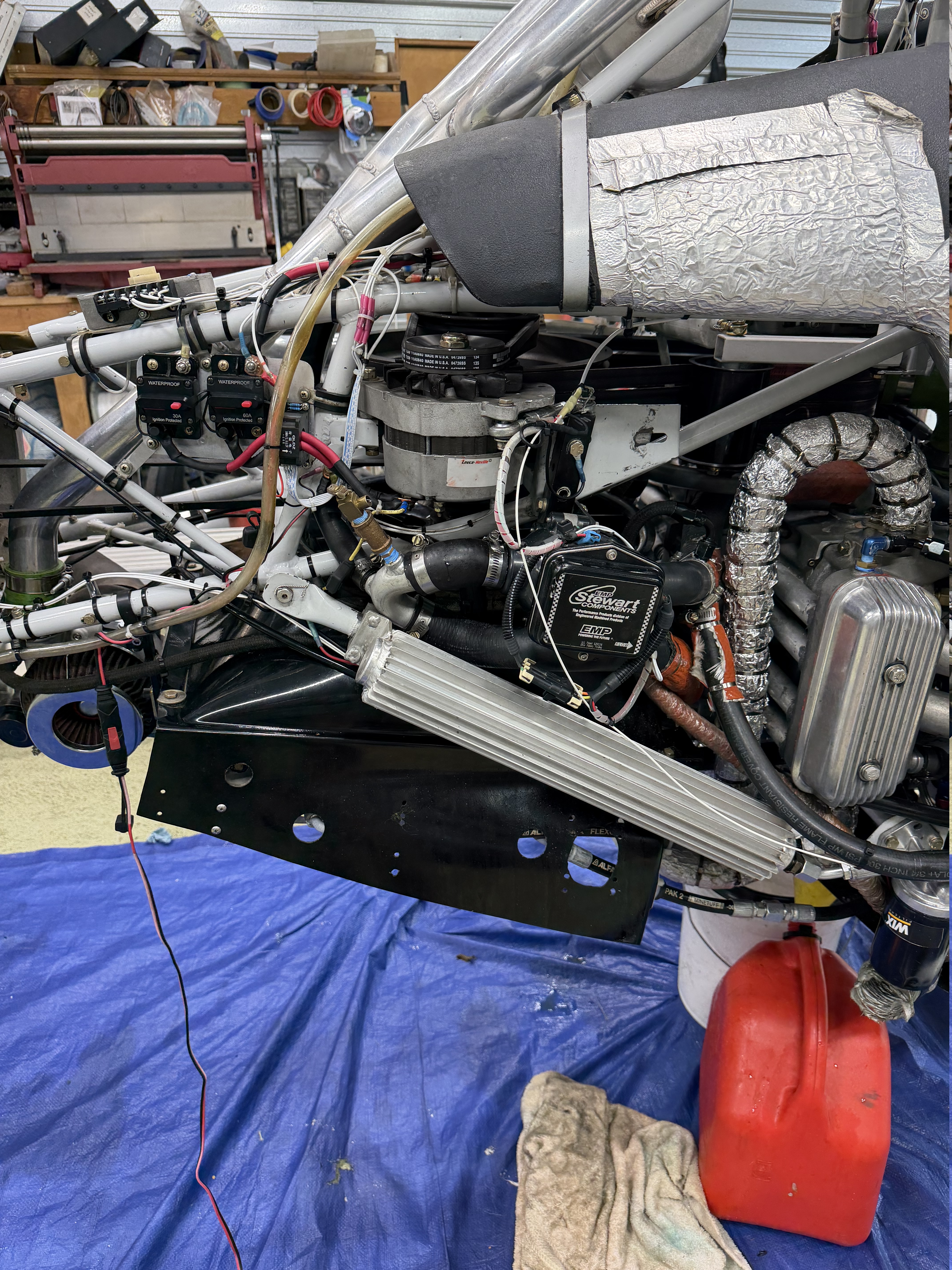

Nathan’s experience is precisely why we began wrapping heavy aluminum tape or foil around the heat wrapped exhaust system to prevent any fluids from being soaked up by the heat wrapped exhaust system. The photo below shows the heavy foil covering the exhaust heat wrap.
