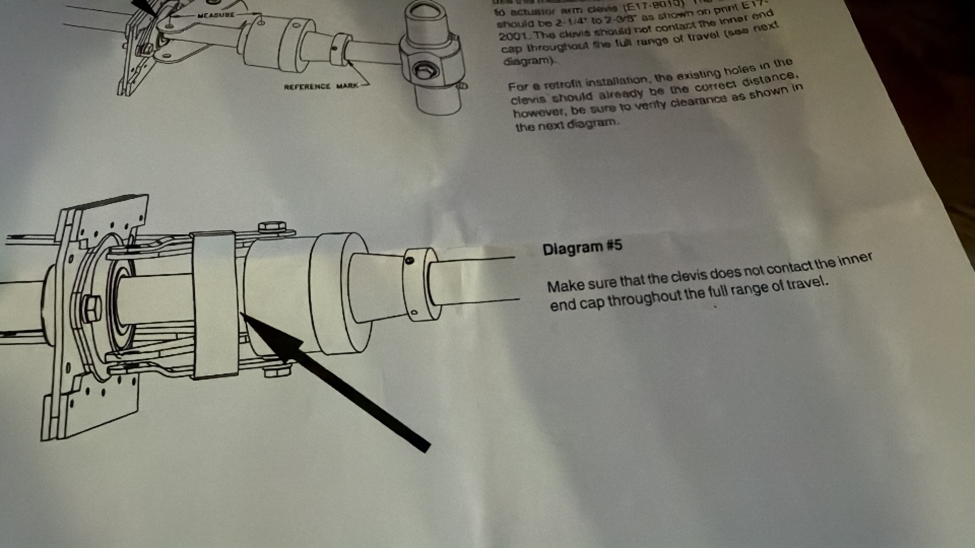

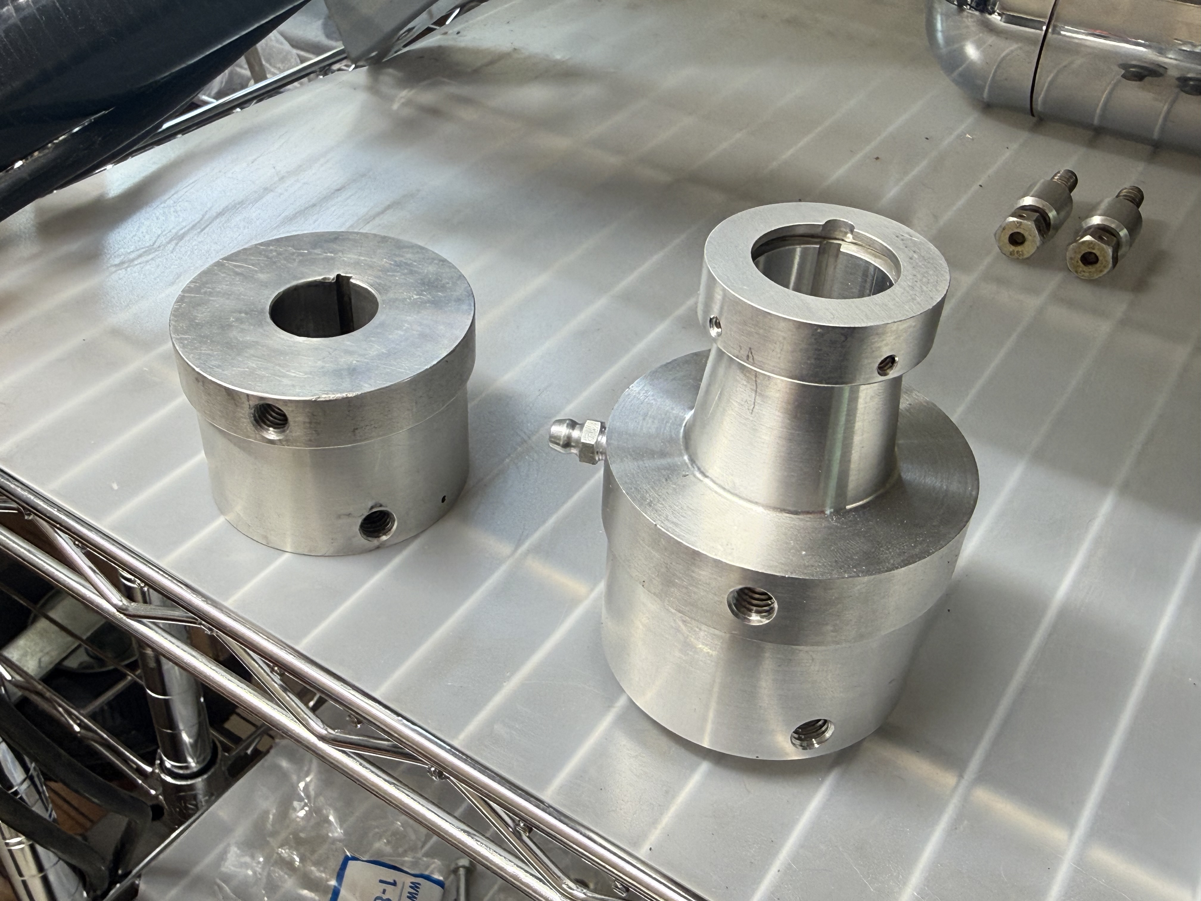

i just got the new style slider carriage(TR swashplate)(spider)(whatever you wanna call it) and i am having an interference issue with the end stop/seal holder. instructions just say ensure no interference not how to alleviate any. is it as simple as grind away the clearance ~1/8" of material from the "web"?
i'm sure this is due to my clevis being for the old style, maybe there was an update to the clevis.
not a huge issue, mostly posting to share info incase someone comes across this in the future.
