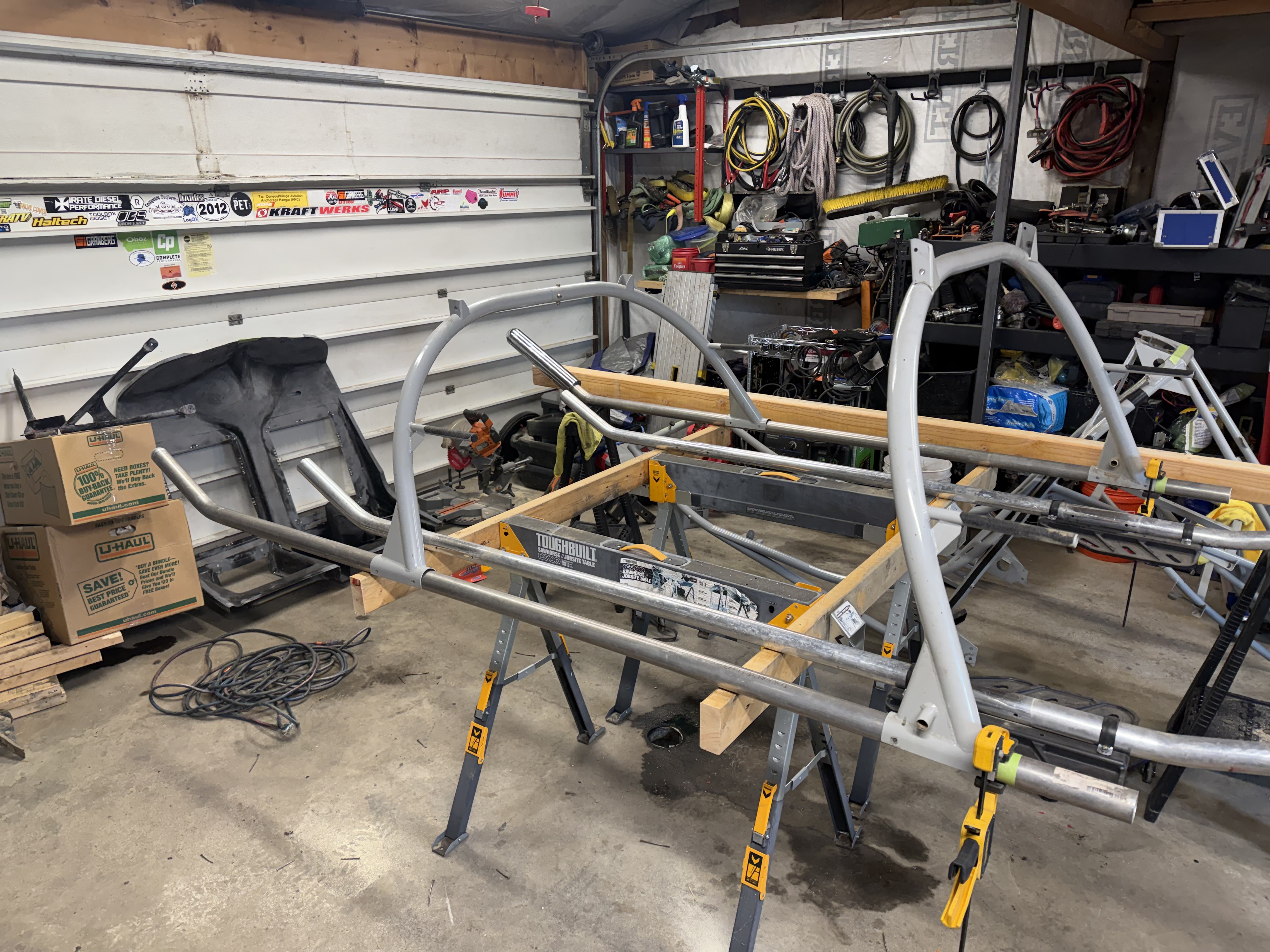

Those that have been around Rotorways for a while will have noticed that many ships have reversed the front landing gear and then extended and reinforced the skids. About 25 years ago Greg Anderson hired me to travel to Rapid City, SD to go over his new kit and to make recommendations as to what improvements I would make to the kit if it was my own. The Rotorway community had lost a number of helicopters due to rolling over during emergency or precautionary run-on landings. The first change that I suggested was to improve the helicopters ability to perform a run-on landing without the helicopter experiencing a dynamic rollover. Today most 162f gear and several Talon gear have incorporated this modification which allows a much more robust support for that one time that you need to slide it in. You can read the full story and view photos of the mod by clicking the green button at the top of the page, go to Hints and Tips, then Landing gear. Happy and safe flying.

i did make new skid tubes for my ship, extending them, sleeving them, and using 2024-t3 vs the 6061.
but the front hoop reversal i held off on doing purely for aesthetics... i did sleeve past the front hoops. just hoping this is enough to prevent nosing over, nothings more important than losing that forward energy in the flare during an auto from what it sounds like.

Got that right. As long as your front portion of the shoes have a steel tube insert that extends back past the front gear leg so that both bolts secure them you will be good. Also be sure to install steel skid shoes.

That’s interestingI’ve already noticed modified (or “reversed”) nose gear configurations on some light aircraft at European air shows, though I haven’t always been able to clearly understand their functional purpose. Based on the photo in your first post, this seems primarily to alter the ground geometry and the position of the nose wheel’s contact point, with possible implications for taxiing stability and turning behavior, rather than creating a “nose-down attitude” per se. As an engineer , the first thing I would look at is still the weight and balance. Not because the landing gear position would alter the center of gravity itself, but because it directly influences the stability margins relative to that center of gravity. With this in mind, did you weigh the aircraft again after the modification to verify that you are still within the weight and balance (W&B) envelope defined by the manufacturer? I’m drawing an analogy here with tricycle-landing-gear aircraftof course, on the Rotorway A600 or other skid-equipped helicopters, the issue is different since the aircraft rests on skids rather than wheels. From a regulatory standpoint, I also have some questions: depending on the authorities and the classification of the modification, this type of change (which could potentially affect ground geometry and handling) may require a technical reassessment and, if necessary, a dedicated flight test program. In Ireland, for example, the IAA generally pays close attention to any modification that could affect flight characteristics or safety margins, taking a case-by-case approach. I am certainly not questioning the modification itself I simply want to better understand the technical and administrative implications.

I reversed mine and I did re-do weight and balance. The forward ballast position does change. Everything is still within CG range.
When you envision a run-on landing especially on grass or dirt, the weight moment is going to stand you up on your nose as you decelerate. Everything being equal, I would rather have the rotation point as far forward as I can.
