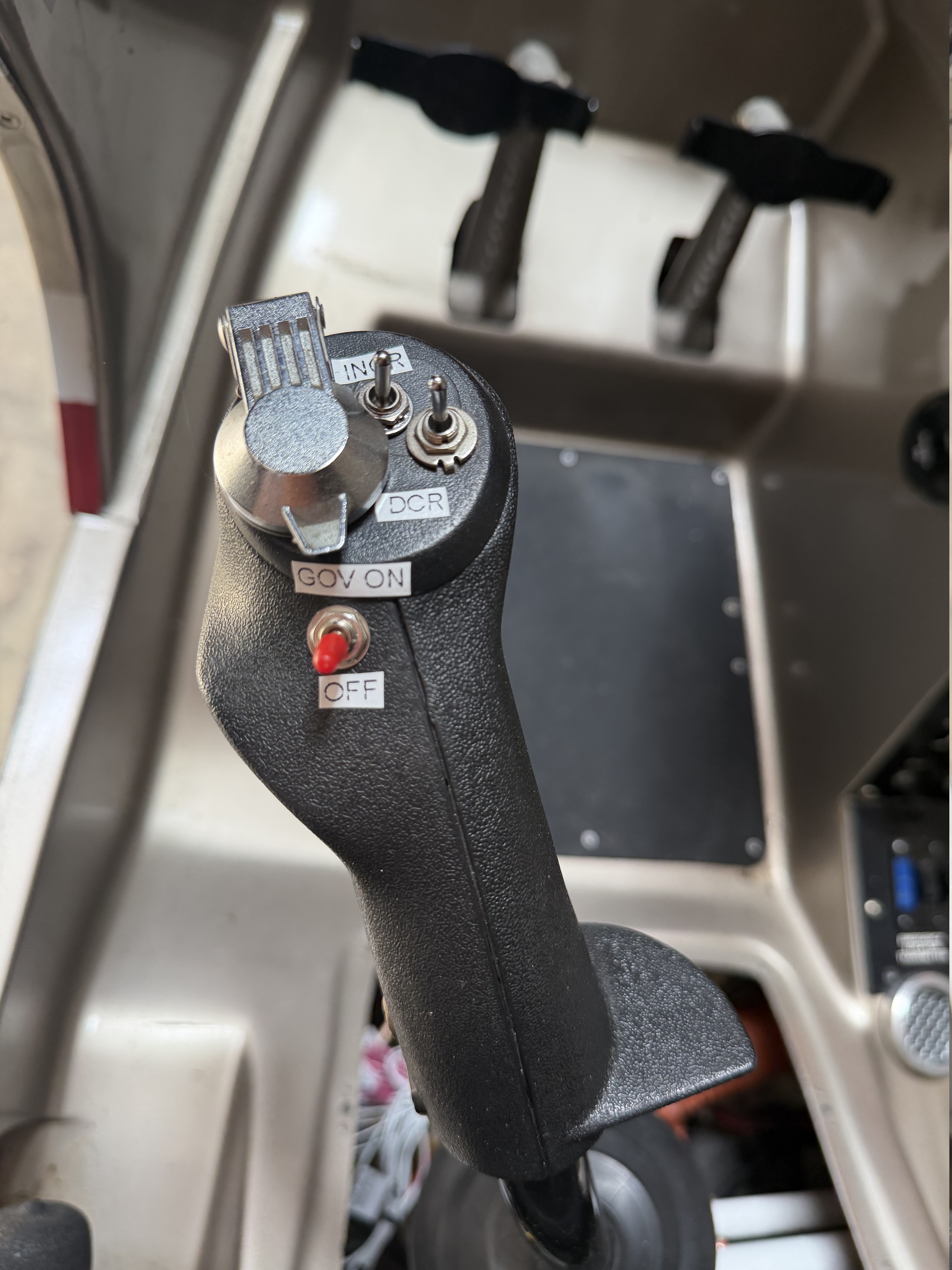

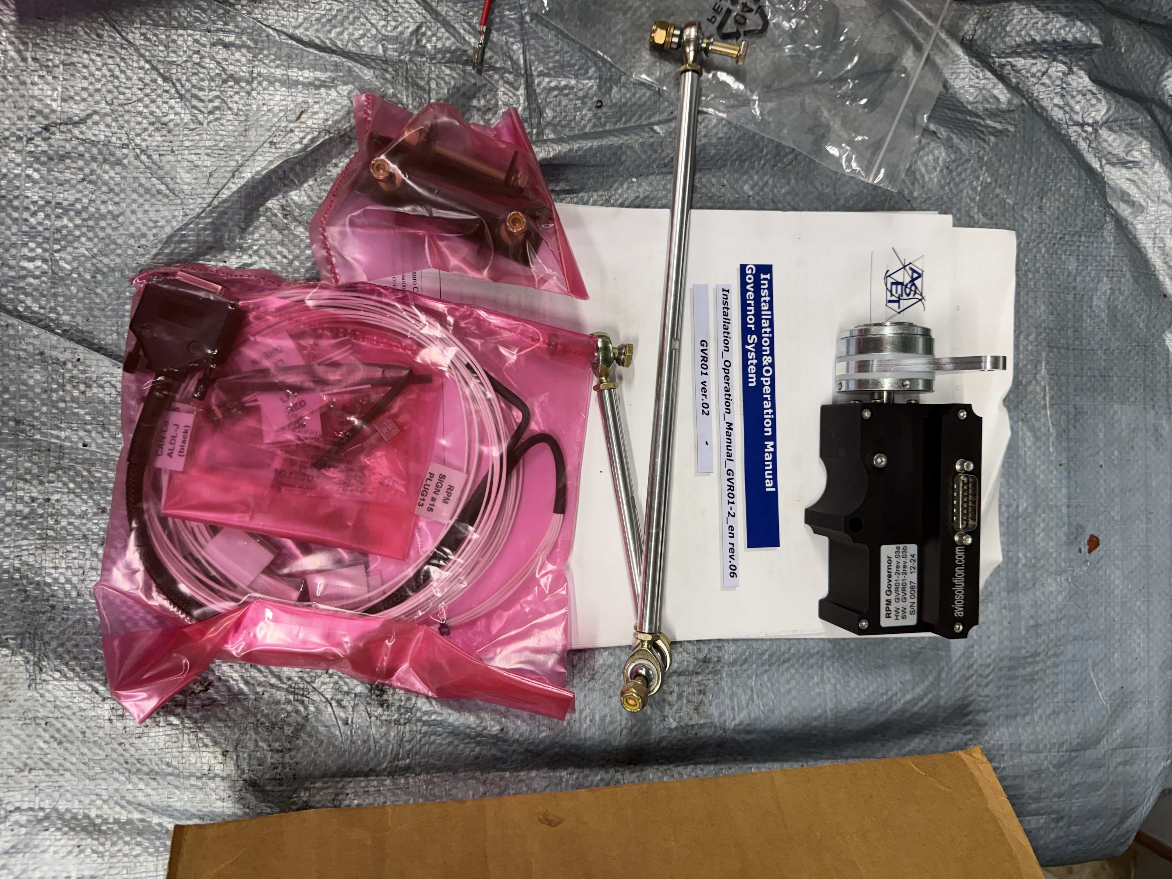

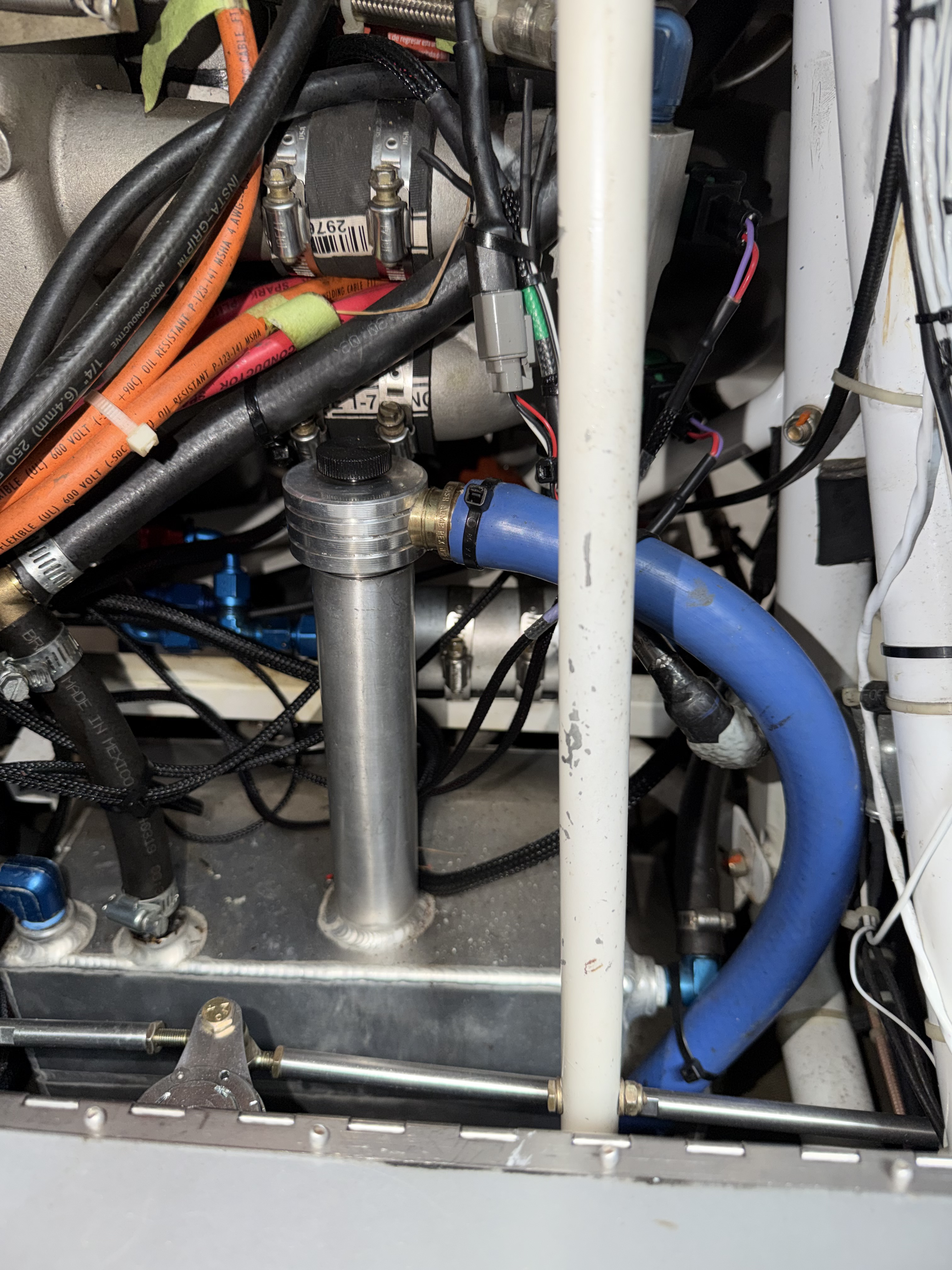

To date I have installed 6 ASET governors on Rotorways and have been extremely happy with them. I have found that the installation is straight forward and it takes me under 8 hours to complete the total installation including the wiring and installation of the switches on the pilot side cyclic grip. I have one on both my Turbo 162f and my NA Joe Huff powered 162f and love to fly with them. I no longer need to have one eye glued to the RPM needle while flying and l love the fact that I can feel the throttle twisting in my hand as power is applied or decreased. I highly recommend installing this governor in your ship and if you need help with it I have everything here in my shop to get it done, you bring the governor kit.
